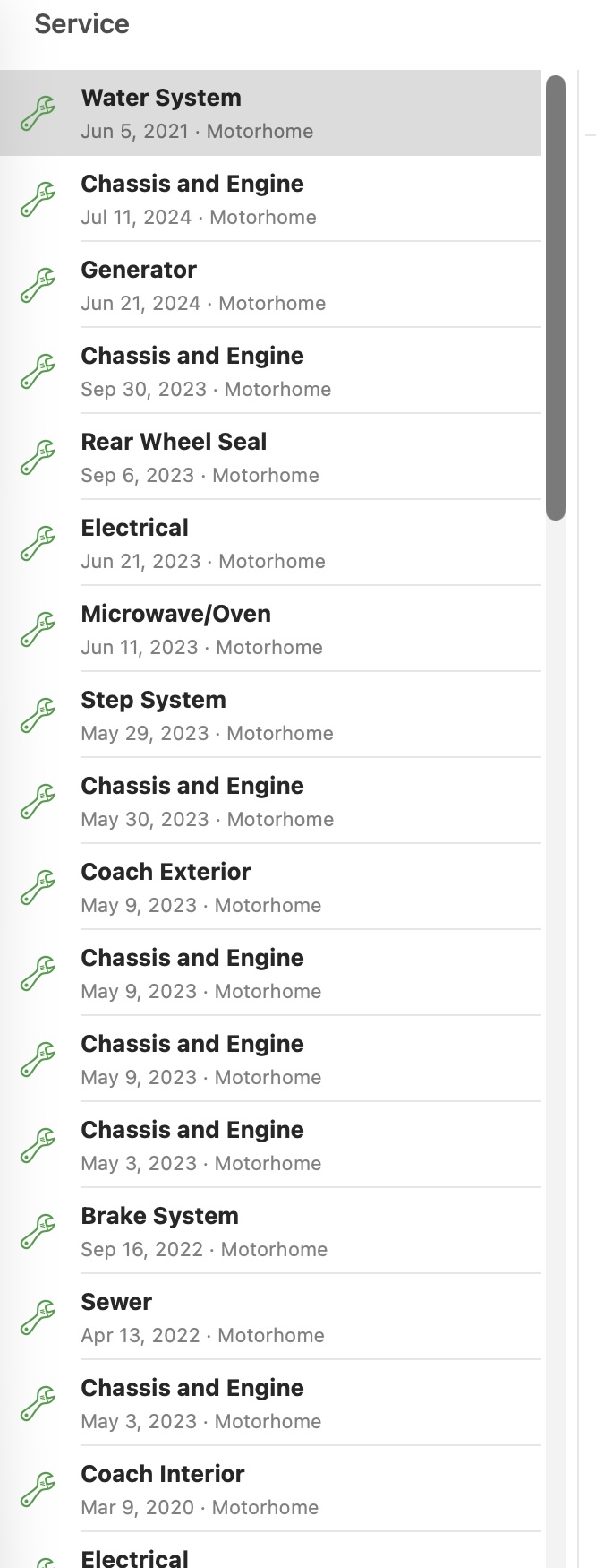

Additionally, I can’t make sense of the order in the service list. It is not in date order as other lists are, it also is not in name order - I would think date order is the preferred order . . but is also not in database record order either so I’m at a loss on that one . . will attach picture of what the list looks like.

Thanks Steve. Both bugs fixed for the next build. Service Records are now listed in a sane order, and the vendor field is now properly imported for future imports.
