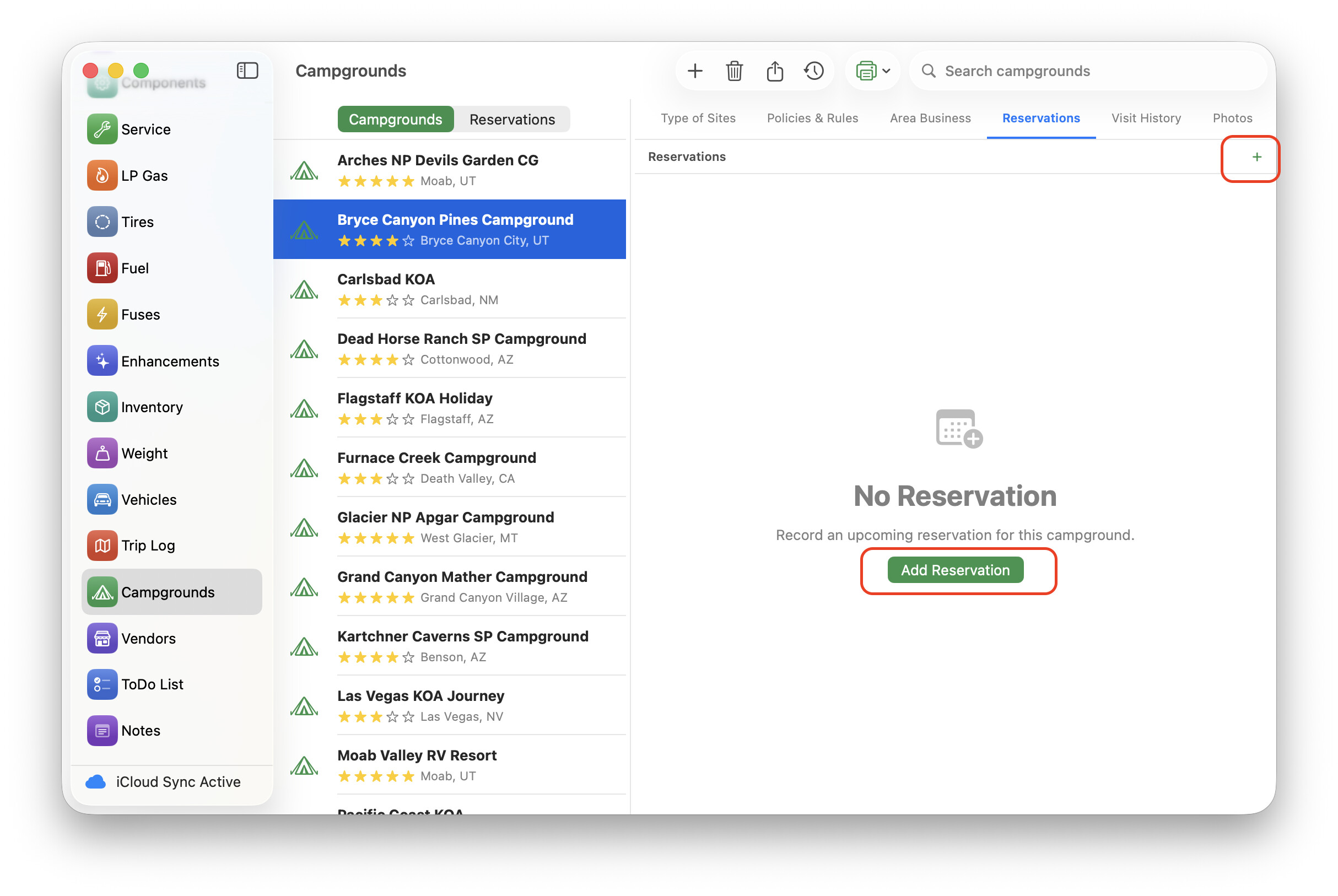

  1. Campgrounds - still will not allow entry for Reservation/Visit History or Photos. Continues to Bring up the “New Campground” popup. (all three devices)
  2. Campgrounds - in iPad and iPhone, the visit history is blank for all Campground records. Visit History does show on the Laptop

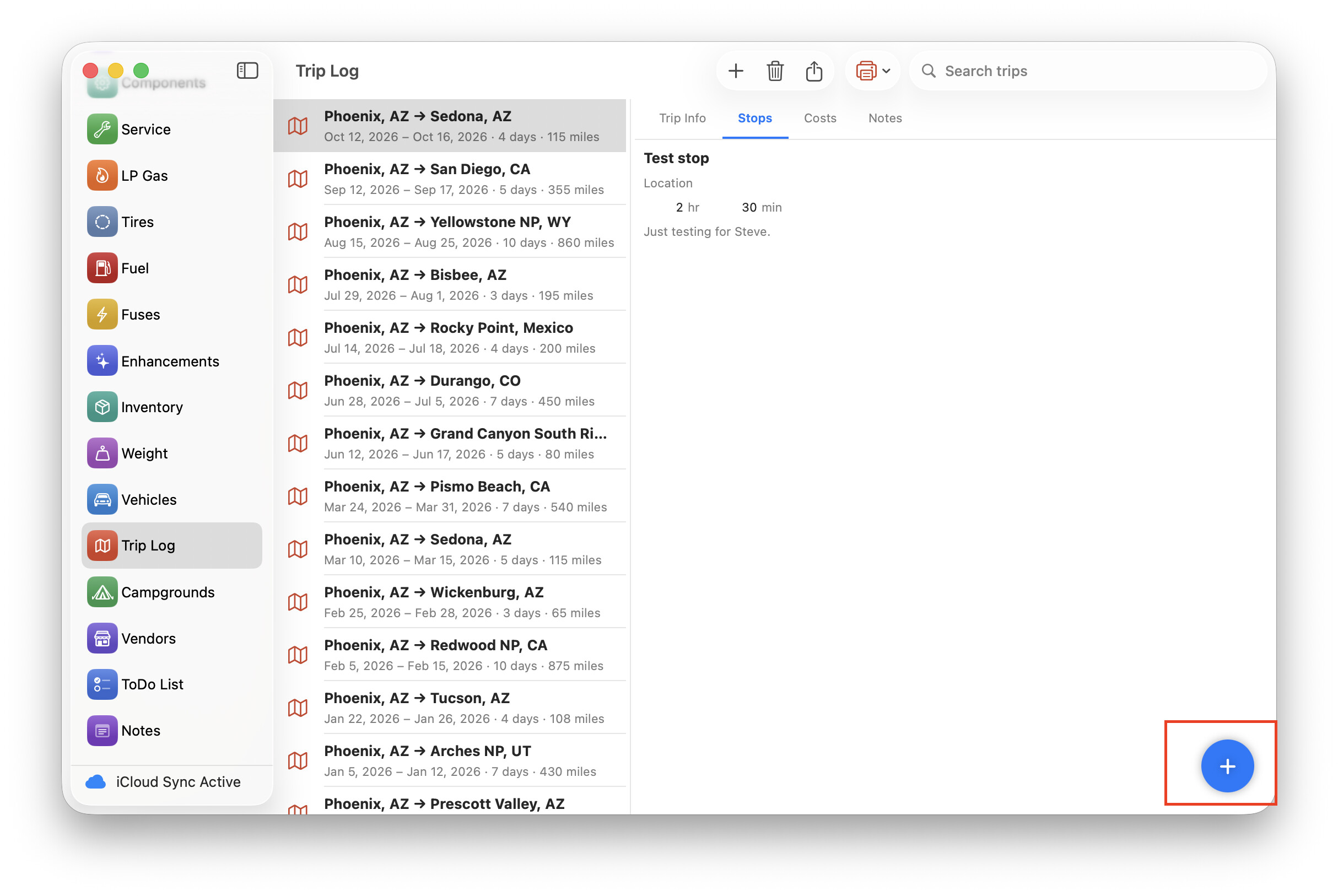

  3. Trip - Stops - Still brings up “New Trip” popup instead of allowing trip stops. (all three devices)

  1. This works for me on all three devices. Are you clicking/tapping the right + button? The one at the top will always mean “Add A New Campground”. But when you tap the Reservations tab, you should see a large “New Reservation” button on the screen if you have no reservations for that campground. If you do already have one, you should be able to add another with the little add button top right.
  2. I can’t recreate this one at all, it works for me on all 3 devices. I’ll do some investigating!
  3. Same as the Campgrounds, are you tapping the large + button at the top? When on the Stops tab, you should see a large button bottom right on all 3 devices. That’s the button to add a stop. (See screenshot below)

Duh!! Yes, I was tapping the top plus sign! Everything works correctly - my only defense is that is not the most intuitive thing - looking for a different + sign. . . I never saw them but I wasn’t looking for them either . . my bad . . . certainly will look closer from now on!!
